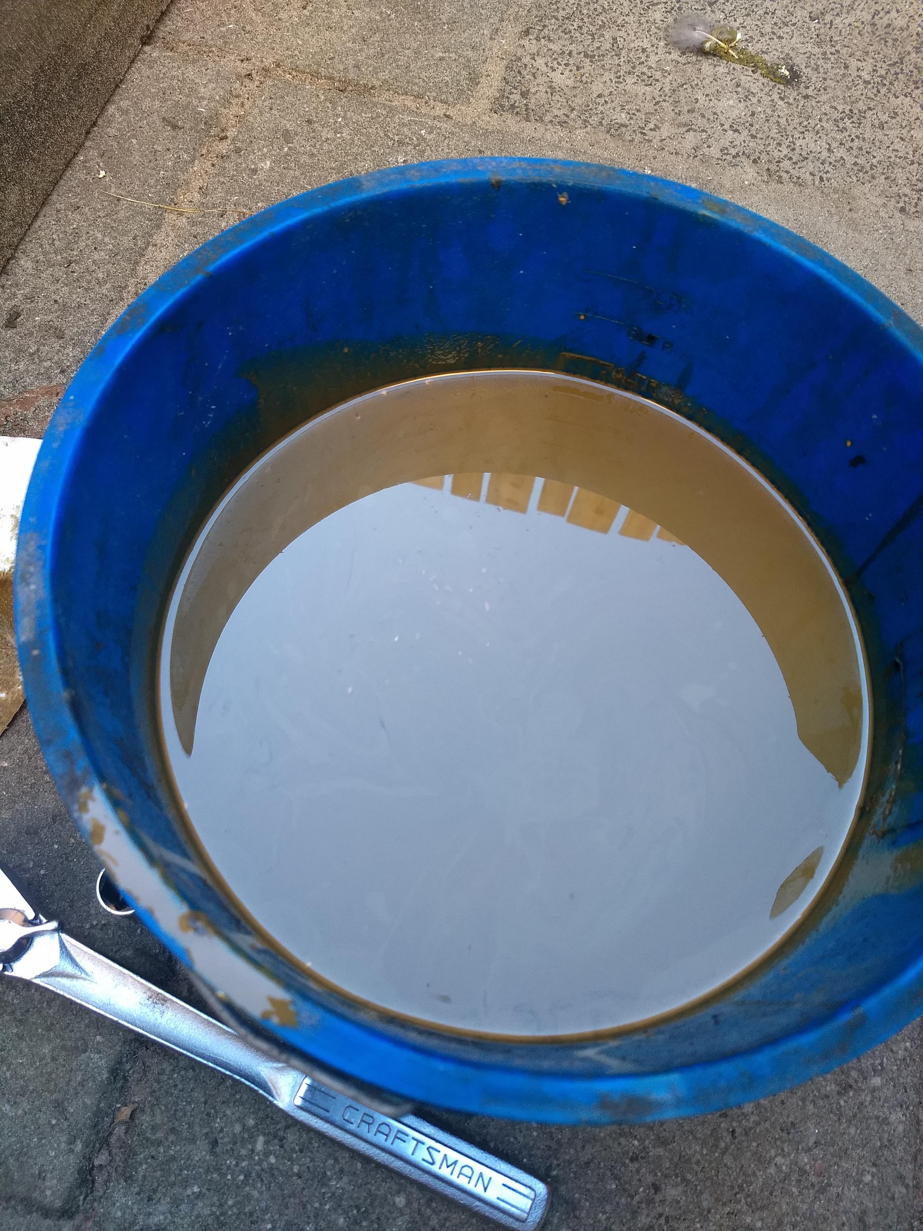

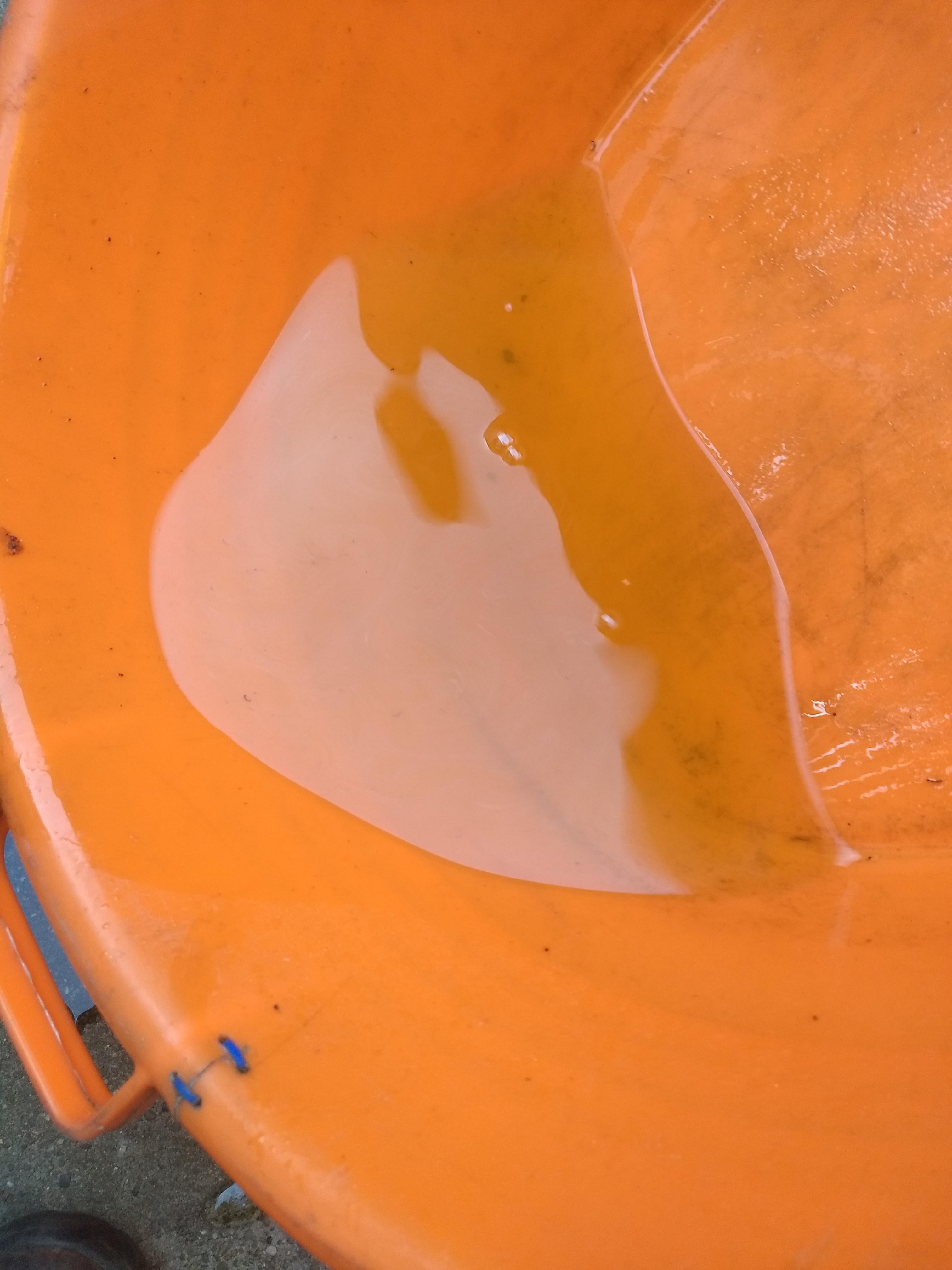

AK47 Posted December 30, 2019 Report Posted December 30, 2019 Drained the sludgy oil today after i overheated on my way back from Stuttgart. Yep, more proof besides the low cylinder compression. Will have to drain the coolant and pull the head out if the weather is not too cold outside. 😒 Quote
AK47 Posted December 30, 2019 Author Report Posted December 30, 2019 Coolant doesn't look contaminated. But I think oil did not get into the jacket. Quote

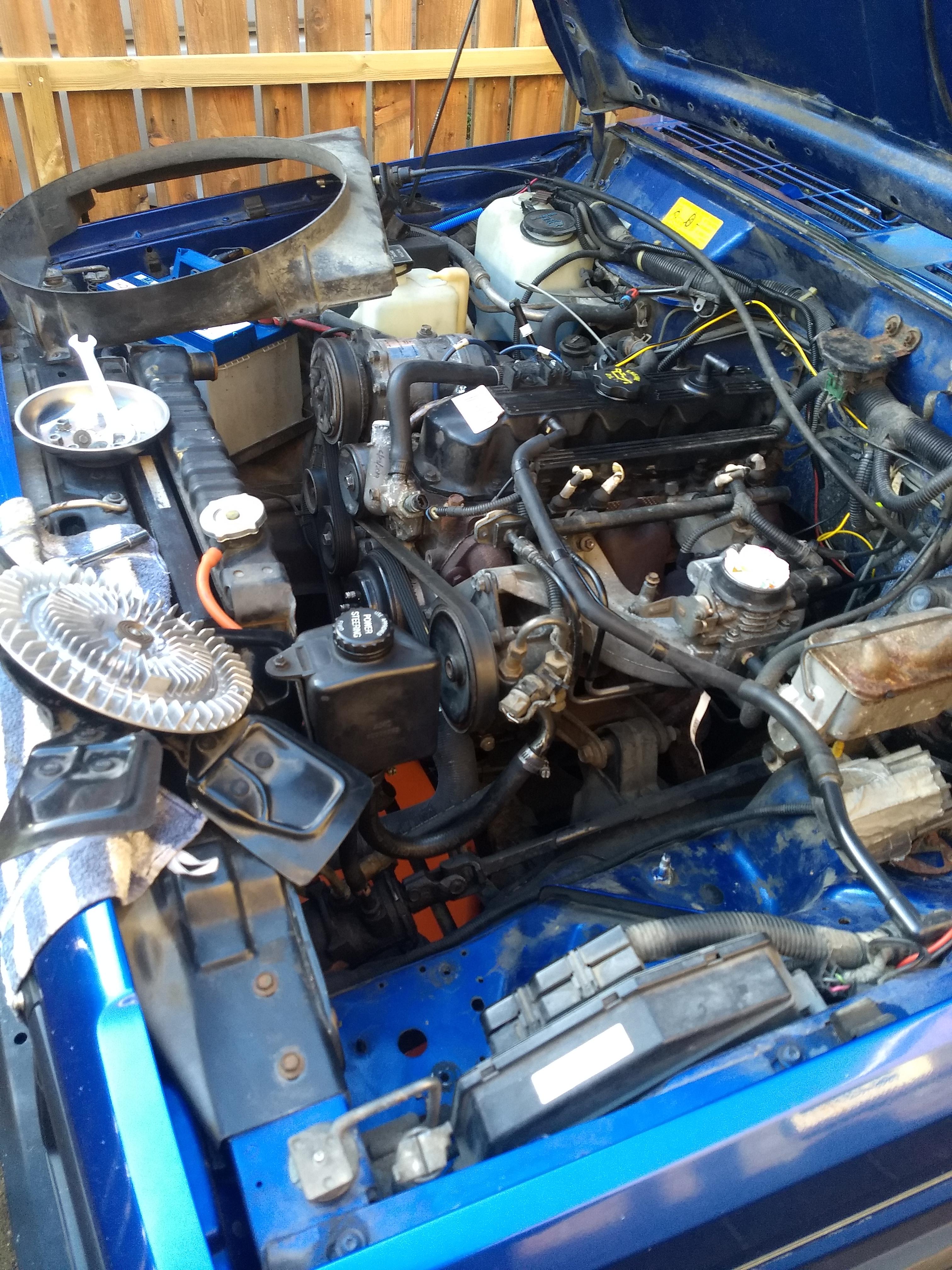

AK47 Posted December 31, 2019 Author Report Posted December 31, 2019 15 hours ago, Arjanw said: We will begrijp jou one way of die andere! 😂 Thanks Arjan and @JeePee for your support! I promised my son some oliebollen this afternoon for oud en nieuw so I had to stop at the fan and fan shroud, and the air box removal. Will continue after the new year. I have to find more carbide! Quote

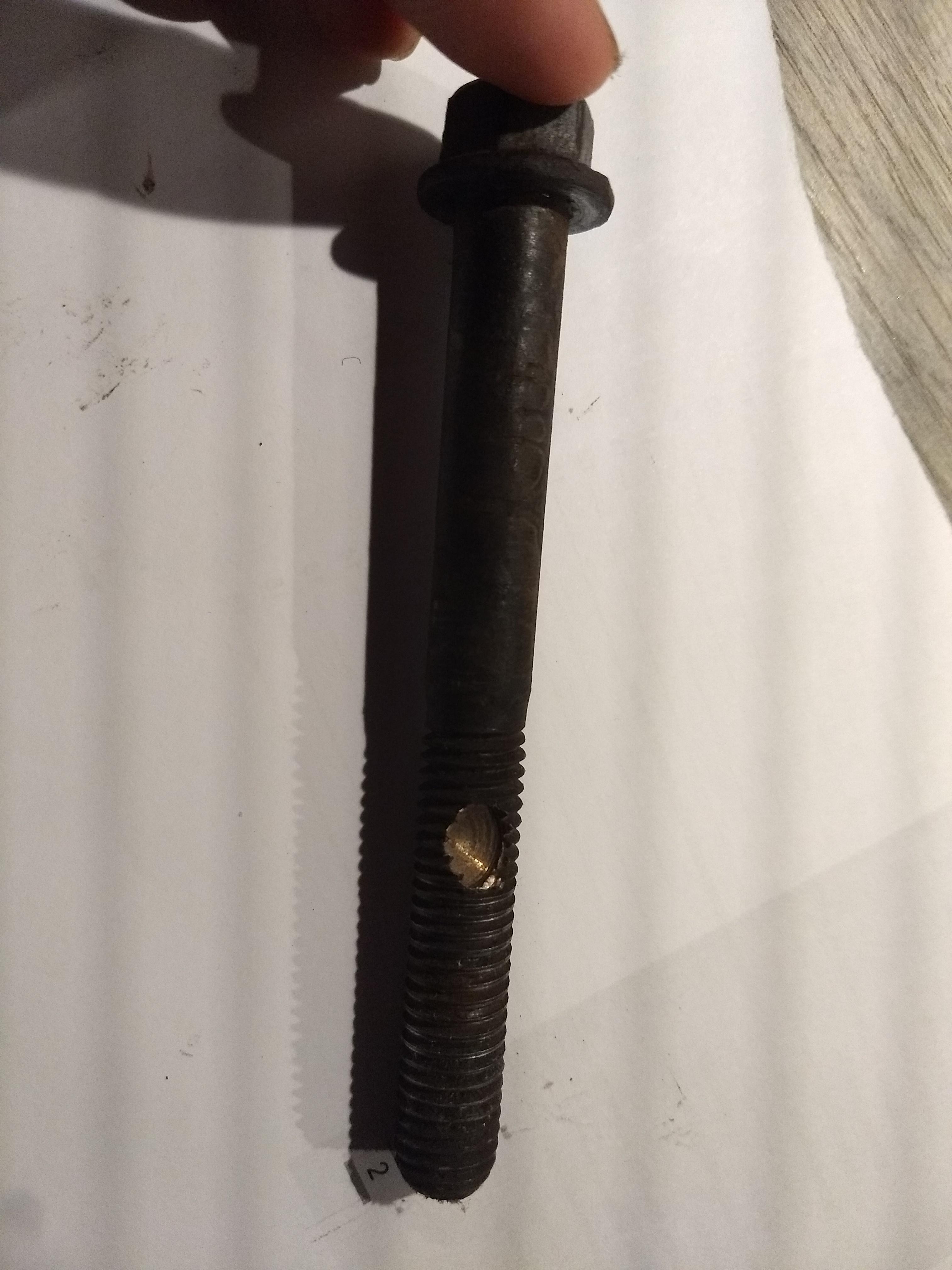

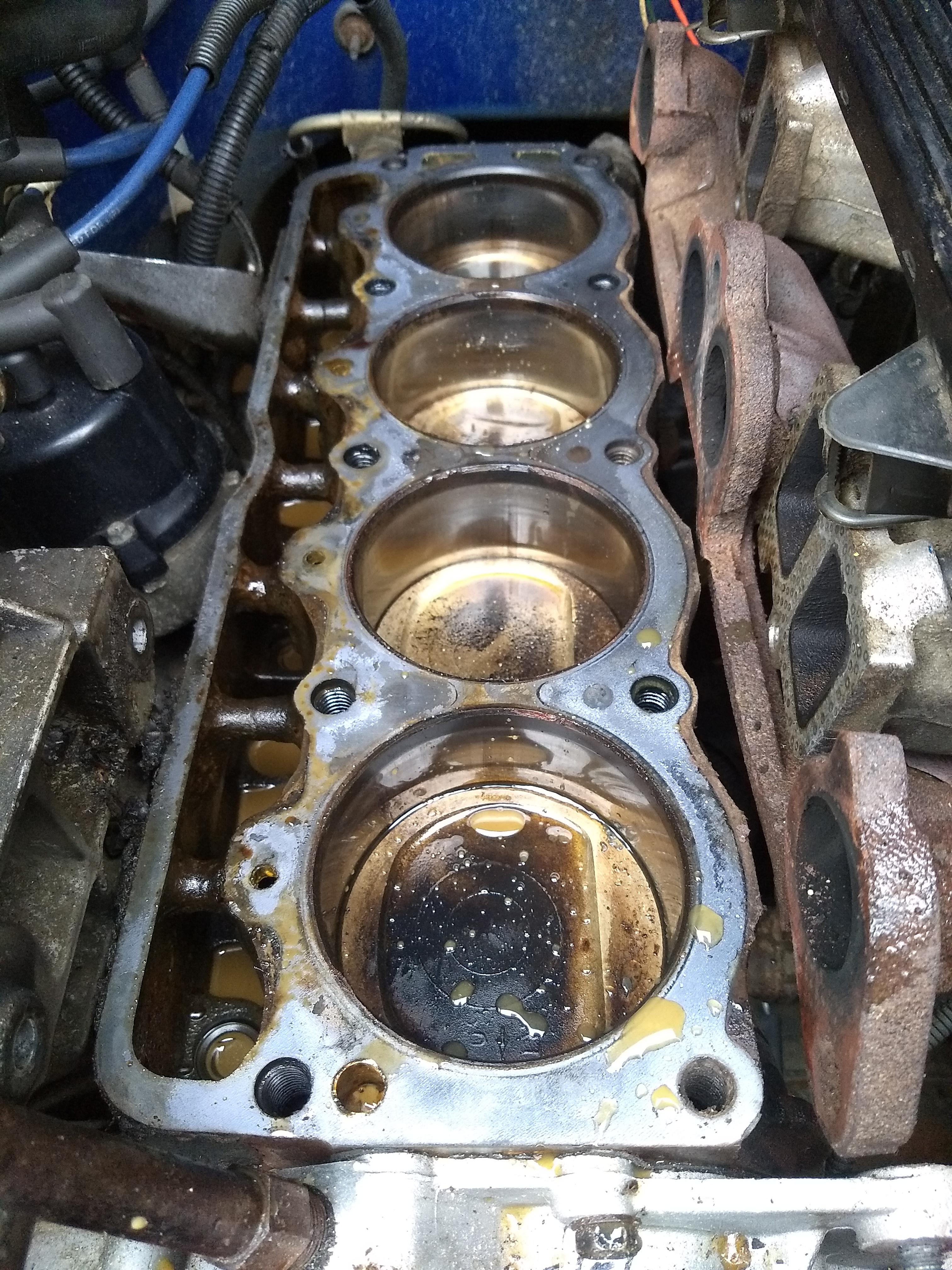

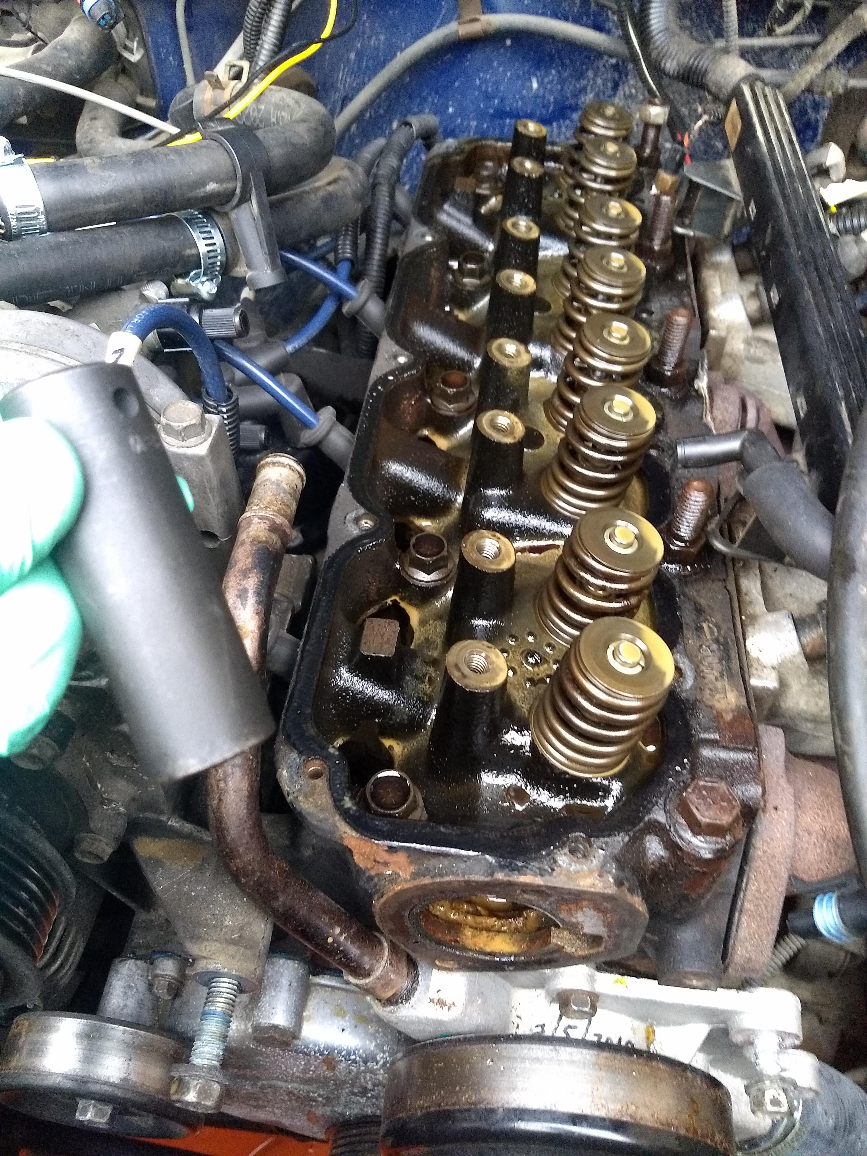

AK47 Posted January 4, 2020 Author Report Posted January 4, 2020 I think I ate too much oliebollen! But not enough of my preferred beer (Alaska Amber). Maybe I should try brewing beer this year. Wel, I finally have the head bolts out. It turns out that the exhaust manifold bolt nearest the radiator was too long ( a replacement when I changed my exhaust manifold 9 years ago). Anyway, this head bolt that goes through the water jacket will not be reused. In fact I have a new set of head bolts so I'll just make a couple of mounting studs from the old ones for the head reinstallation. The disassembly so far is going smoothly. I removed the intake amd exhaust manifold bolts without problems. I am leaving one bolt in place to keep junk from falling into the manifold gap. All that's left is for the A/C to be moved and the spark plugs. I heard some people have used brass tumbler to clean loose parts like bolts and nuts. I have an old tumbler from when I used to reload my 30.06 bullets for hunting moose (eland) and grizzly bears. I may try that, although it might be enough to run the bolts through a steel brush. Oh, and I found that my engine has the component code "B" stamped on the block. This means my cylinder bores are 0.010 overbored from the factory (according to the 1994 FSM). I never really looked for it before but I decided to take a peek now. So just a little bit more and I'll be bringing the head to the machine shop next week. Quote

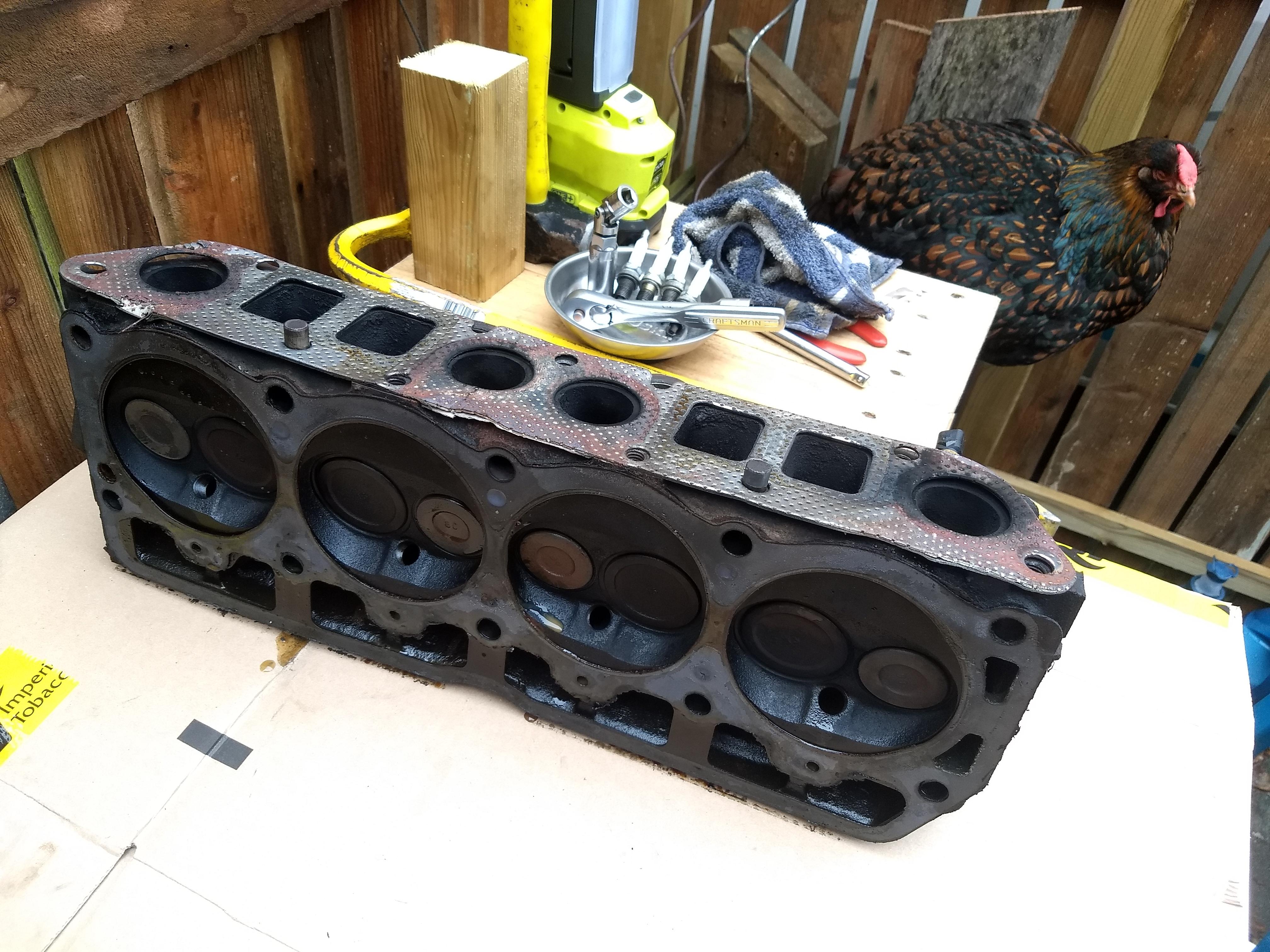

AK47 Posted January 5, 2020 Author Report Posted January 5, 2020 So, finally got the head out today; will clean it tomorrow and bring it to the machine shop. I pulled the lifters and will do a close inspection. Will also talk to the machinist about the cylinders. I didn't see any obvious damage but I need to clean it first before doing an inspection. I should remove the oil pan and clean it. But I'll wait until next week. Quote
AK47 Posted January 6, 2020 Author Report Posted January 6, 2020 €250 voor een head job (planing, Magnaflux, valve cleaning) bij Ausma Motorenrevisie. Hmmm. Is that a good price? I think it's reasonable. I'm getting the head back on Friday. Meanwhile I have lots of cleaning and scraping to do. Quote

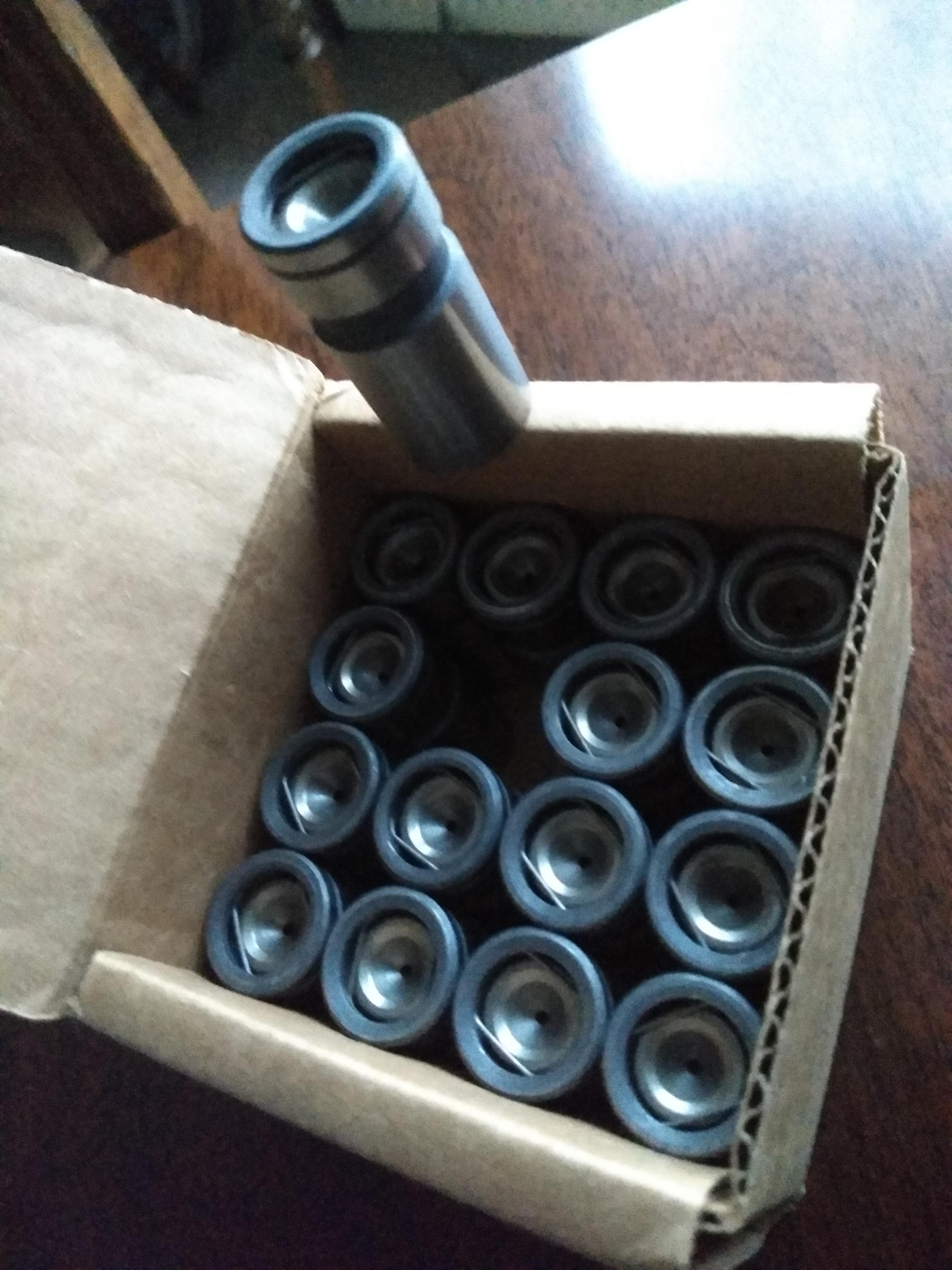

AK47 Posted January 8, 2020 Author Report Posted January 8, 2020 Sooo, after careful inspection, my lifters are concave. 😒 I've now ordered a set but it will be another two weeks. Hmm, do I install the Powertrax No-Slip locker in my Chrysler 8.25 while I wait? It's been sitting in its box for a year now. Anybody have good experience with this brand? Quote
Arjanw Posted January 8, 2020 Report Posted January 8, 2020 2 uur geleden zei AK47: Sooo, after careful inspection, my lifters are concave. 😒 I've now ordered a set but it will be another two weeks. Hmm, do I install the Powertrax No-Slip locker in my Chrysler 8.25 while I wait? It's been sitting in its box for a year now. Anybody have good experience with this brand? If you replace the flat tappet lifters you better also replace the camshaft. Those two are married for life, if you know what I mean. Quote
AK47 Posted January 8, 2020 Author Report Posted January 8, 2020 39 minutes ago, Arjanw said: If you replace the flat tappet lifters you better also replace the camshaft. Those two are married for life, if you know what I mean. Yep. That's on it's way here, too. Ah well, just more work. Thanks. Quote

AK47 Posted January 15, 2020 Author Report Posted January 15, 2020 "I've lost the struggle within and rebuilded the entire engine" Haha! Yes, we have all been there. I can't wait for the garage to be built. The groundwork starts in April (I think). In the meantime, the Jeep is sitting in my driveway and the wife is not too happy about it. So the sooner I get it out of the way, the better for my marriage 🙄. Anyway, the camshaft arrived today, and I now have a tube of Clevite Cam Guard (€4.50 at Dabeko). The cylinder head is also back from the machine shop (€235 final cost) and ready to install. So... a bit of good weather and some time off work, then I hope to continue with the project! Any tips on removing the condenser from behind the grill? I need some room to pull the camshaft out. I already have the radiator out but it looks like I will have to unbolt the whole front face (again). Maybe I don't need to remove the condenser. Quote
